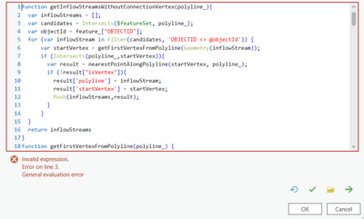

The following code was working fine in 3.0 and 2.9 bot not anymore in 3.1. Can anyone tell me what has changed? I get an "General evaluation error" on line 3:

I get this error already during code check:
So I can't ran the validation and check with fiddler.
