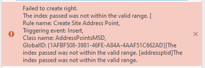

Working on the attribute rules in the address data management solution v2. The address point rule "Create Site Address Point" is giving me an error about indexing that it difficult to troubleshoot. It seems like this rule is looking for the addressptid created in the Address Point ID rule but not finding it. Any suggestions on getting one rule to initiate before another? Anyone else seen this error?
Here is the rule.

ChrisFox
@JamesBurton1, I see the issue. There is a bug in my script that we don't typically encounter because in the default schema we have the same field name for the addressptid in both the AddressPoint feature class and the SiteAddressPoint feature class. Looking at your script you have a different name:
// Define the Address Points fields
var id_field = "addressptid";
var offdist_field = "offdist";
var offdir_field = "offdir";
var numpoints_field = "numpoints";
var incrementval_field = "incrementval";
var capturemeth_field = "capturemeth";
// Define the Site Addresses fields
var addressptid_field = "addressid";
The issue occurs later in the expression when we attempt to create a new SiteAddressPoint, I am referencing the id_field variable from the AddressPoint feature class rather than the addressptid variable for the SiteAddressPoint feature class:
Push(adds, {
'attributes': Dictionary(id_field, id, status_field, defaultstatus,
addrnum_field, addrnum, roadfullname_field, intersectingRoad[fullname_field],
addrcapturemeth_field, $feature[capturemeth_field]),
'geometry': newPoint
This is why it is saying the index addressptid doesn't exist, because that field doesn't exist in the SiteAddressPoint feature class. If you change that section of code to below, it should work:
Push(adds, {
'attributes': Dictionary(addressptid_field, id, status_field, defaultstatus,

JamesBurton1
Thanks for the reply @TedHoward2. I tried adding these to both rules but I'm still getting the same indexing error.
JamesBurton1

Push(adds, {
Push(adds, {
JamesBurton1
You're the man @ChrisFox, that solved my indexing error. Thanks!
ChrisFox
Push(adds, {
Push(adds, {
