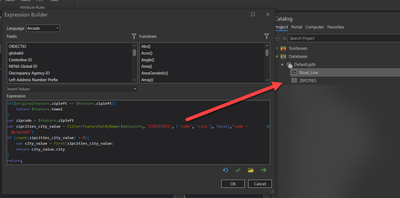

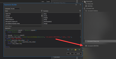

This issue seems to be resolved in later versions of ArcGIS Pro as in the example below I am using ArcGIS Pro 3.1.1 and a Postgres EGDB and copy and pasting a Attribute Rule that refences a database schema and table copies to the file geodatabase just fine. Road_Line AR refences the cch.owner1.ZIPCITIES table for data. Copying the Road_Lines to the Default.gdb also copied over the referenced ZIPCITIES table without me doing so.
The code on the enterprise database feature Road_Line referencing a database schema table
Copy and paste successful of just the Road_Line and database schema table copied over on its own (ZIPCITIES). The attribute rule on Road_line drops the database schema.
