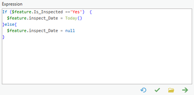

Having a GDB with a Feature Class called `Inspection` and a Domain (InspectStat) with "Yes" and "No" coded values which is assigned to `Is_Inspected` field, I want to enable user to Add Today() date into `Inspect_Date` field  when `Is_Inspected` status change
If ($feature.Is_Inspected =='Yes')  {
$feature.Inspect_Date = Today()
}else{
$feature.Inspect_Date = null
I used Calculation immediate rule against the Is_Inspected field and Triggers are Insert and update but when I update the value of Is_Inspected (using domain "Yes" or "No") I am not getting any changes/updates on `Inspect_Date` and it is always null

You need to return the edit, setting it on $feature does not affect the feature

Ok I updated the code to this
return {
    "result": $feature.Inspect_Date,
    "edit": [{
        "updates": [{
            "Inspect_Date": Today()
but still not working
