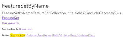

If you look at the documentation for FeatureSetByPortalItem, it doesn't include Attribute Rules as one of the profiles it works in.

As you said, Attribute Rule is not included in FeatureSetByPoralItem, I gave it a try FeatureSetByName instead; however, it did not work either. Do you know any limitation in this case?

Profiles are the rules in how different Arcade functions can be used. For example, the Labeling profile doesn't allow you to use the FeatureSet functions due to performance issues (see this post). The FeatureSetByName function works with items in a specific map or feature service, not any item on a Portal.
