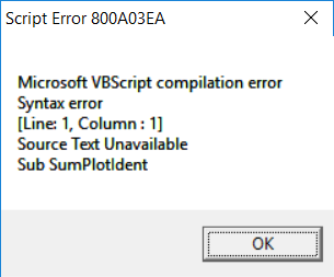

I have set plotId and plotIdent as variables, from my understanding "txtfarmer_id" and "txtplot_ident" should be the fields identifiers used in the form. I have put this script in the onchange event for the txtplot_id field, which should be objControl, right?
I keep getting following error message and have no clue what to look for:

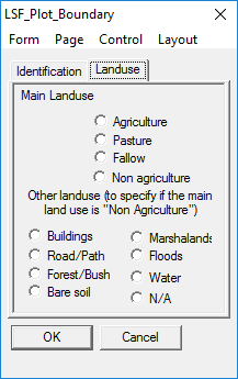

only that I have radio buttons at the moment and no combo box . It's also not that complicated - I only want to hide the next set of radio buttons when for the first question the answer is Agriculture:
I changed the radio buttons to combo boxes to make it easier to check for the selection, so the first is cboMain, the second cboOther.

I am getting the same error message as for the first script SumPlotIdent.

I figured out in the meanwhile that I just have to remove the Sub... and End Sub to make the script to run. So the concatenate works already (can't test though if it's also written to the file but that should be enough for now).
For making the combobox invisible I wasn't that successful yet unfortunately. I have tried it first in the onchange event but nothing happened when I changed the selection. So I tried with the onselchange event. At the moment it works quite ok: the second comboBox is disabled when in the first the selection with the value=96 is selected. Funnily in between only the values not the texts for the comboBox list items were shown but now it's fine. But I can't tell what I did differently now... That's the current status:

2) to hide/show a second comboBox (cboOther) depending on the selection in the first comboBox (cboMain). My script here is based on https://community.esri.com/thread/74367
Dim objPage, objControl
Set objControl = ThisEvent.Object
Set objPage = ThisEvent.Object.Parent
objPage.Controls("cboMain").Value = 0
objPage.Controls("cboOther").Value = 0
If objPage.Controls("cboMain").Value = 99 Then
      objPage.Controls("Label2").Visible = True
  objPage.Controls("cboOther").Visible = True
ElseIf objPage.Controls("cboMain").Value < 99 Then
  objPage.Controls("cboOther").Value = 8
  objPage.Controls("Label2").Visible = False
  objPage.Controls("cboOther").Visible = False
End If
Set objControl = Nothing
Set objPage = Nothing
Only when the last option (Value=99) is selected, the second comboBox shows up, including the leading text (Label2). This script is placed in the onselchange of the first comboBox. Maybe someone can shed some light on the difference between onchange and onselchange?
