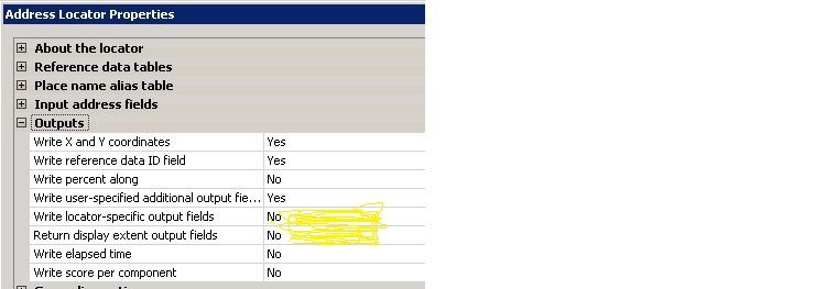

I am creating an Address Locator using ArcObjects and assigning properties to it, primarily through the IGeocodingProperties2 interface.  I cannot find how to set two properties - “write locator specific output fields” and “write display extent output fields" - these do not seem to be exposed by this or any other interface
In the ArcMap GUI, you can set them under Address Locator -> Properties -> Outputs, as shown in the image below
My locator creation code is straightforward.  It expects the feature dataset (featureDataset below) and featureclass (featureClass below) where reference data is stored - to be already known:

You would do it in the following way if you want to do it at runtime:
        ILocatorImpl locatorImpl = locator as ILocatorImpl;
        IPropertySet locatorProperties = locatorImpl.Properties;
        locatorProperties.SetProperty("WriteDisplayExtentFields", "True");
        locatorProperties.SetProperty("WriteLocatorSpecificFields", "True");
        locatorImpl.Properties = locatorProperties;
If you want to do it to the locator and keep them updated, you can modify the .loc file directly using a text ediitor.
