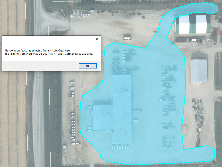

I am writing an add-in that calculates the cost for a spray job.
This next block of code works perfectly for adding a polygon feature to my objClasses list,
But only when the feature's shape is "Polygon", not "Polygon ZM" which is the default shape for the sprayer's control to export.
I would like to know is there a way to modify my code slightly to include a Polygon ZM feature, or will I have to edit the Map and order to disable the Z and M axis.

if (objClasses.Count < 1)
MessageBox.Show($"No polygon features selected from {onLayer?.Name} layer. Cannot calculate area.");
return;

Hi,
Your code works fine on ArcGIS 10.3 if omit part of condition checking:
                if (feature.Shape.GeometryType == esriGeometryType.esriGeometryPolygon && !objClasses.Contains(feature.Class))
                    objClasses.Add(feature.Class);
So issue is with layer name and not with geometry type

Rconrad
That's exactly what I did and it worked just as needed. Don't know why I thought I needed to convert it. Thanks.
