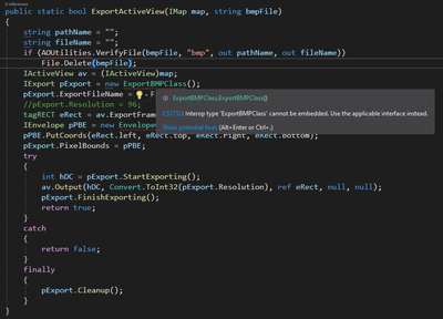

       public static bool ExportActiveView(IMap map, string bmpFile)
            string pathName = "";
            string fileName = "";
            if (AOUtilities.VerifyFile(bmpFile, "bmp", out pathName, out fileName))
                File.Delete(bmpFile);
            IActiveView av = (IActiveView)map;
            IExport pExport = new ExportBMPClass();
            pExport.ExportFileName = bmpFile;
            //pExport.Resolution = 96;
            tagRECT eRect = av.ExportFrame;
            IEnvelope pPBE = new EnvelopeClass();
            pPBE.PutCoords(eRect.left, eRect.top, eRect.right, eRect.bottom);
            pExport.PixelBounds = pPBE;
            try
                int hDC = pExport.StartExporting();
                av.Output(hDC, Convert.ToInt32(pExport.Resolution), ref eRect, null, null);
                pExport.FinishExporting();
                return true;
            catch
                return false;
            finally
                pExport.Cleanup();

Thank you so much for your reply, I just have a few questions though... I keep getting "Interop Type ExportBMPClass cannot be embedded" errors, and I am not sure where the variables "AOUtilities" or "File" come from. Do you have any ideas? Thanks again.
-Rylan Conrad
BrentHoskisson
For ExportBMPClass cannot be embedded:
Find ESRI.ArcGIS.Output Reference and view the properties.  Set Embed Interop Types to false.
You can remove the VerifyFile type call and just enter the path name and file name of your output BMP into the variable initializers.  Then just run a File.Exists on the file name to see if you need to delete it.
