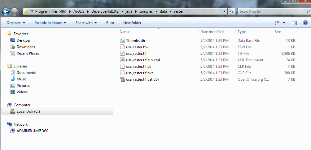

This the contents of raster folder on my disk, is that similar to what you have (attached here)?

Deactivated User
This the contents of raster folder on my disk as attached , is that similar to what you have?
