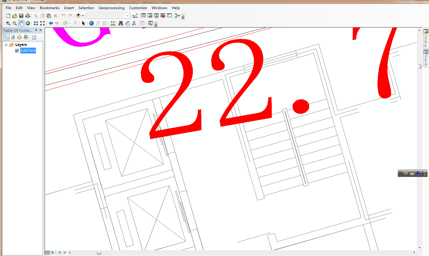

    And I got a map like this, it's pretty good:

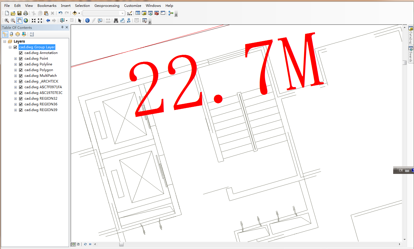

It works, but the map looked like this:
The line color is OK, but the  Annotation is too big compares the the first image, and the whole dwg file becomes one layer.  Since it is become one layer, we can not modify the display of the annotation.

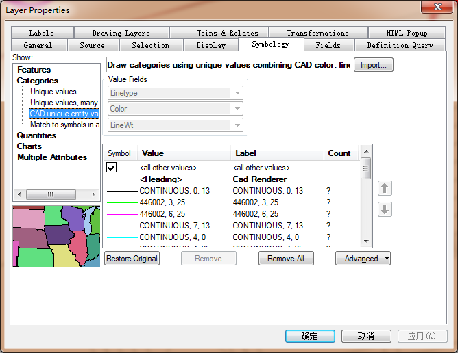

ArcMap using a special renderer for CAD .dwg file, it is very difficult to do it in Code:

    I searched the document and find that we can drop the .dwg file from a Catlog window instead of using the "Add Data" button:
   This method also creates a group layer, can we automate this process by ArcObjects code? Thanks a lot.

I was looking for a solution for  exactly the same requirement as described in this thread.  Though it is an old thread, it may help someone.  The solution is given below.
Public Sub AddCADLayer2GroupLayer(pGrpLayer As IGroupLayer, cadFolderPath As String, cadfilename As String)
Dim pFeatureLayer As ESRI.ArcGIS.Carto.IFeatureLayer = Nothing
Dim factory As IWorkspaceFactory = New CadWorkspaceFactory
Dim pFeatureWorkspace As IFeatureWorkspace = CType(factory.OpenFromFile(cadFolderPath, 0), IFeatureWorkspace)
Dim pFeatureDataset As IFeatureDataset = CType(pFeatureWorkspace.OpenFeatureDataset(cadfilename), IFeatureDataset)
Dim pFeatureClassContainer As IFeatureClassContainer = CType(pFeatureDataset, IFeatureClassContainer)
For i As Integer = 0 To pFeatureClassContainer.ClassCount - 1
Dim pFeatureClass As IFeatureClass = pFeatureClassContainer.Class(i)
If pFeatureClass.FeatureType = esriFeatureType.esriFTAnnotation Or pFeatureClass.FeatureType = esriFeatureType.esriFTCoverageAnnotation Then
pFeatureLayer = New CadAnnotationLayerClass
pFeatureLayer.Name = pFeatureClass.AliasName
pFeatureLayer.FeatureClass = pFeatureClass
Else
pFeatureLayer = New CadFeatureLayer
Dim iglayer As ESRI.ArcGIS.Carto.IGeoFeatureLayer = CType(pFeatureLayer, ESRI.ArcGIS.Carto.IGeoFeatureLayer)
'Here the Renderer is set
Dim pUID As New UID ' create a new UID objects
'progID is "esriCartoUI.CadUniqueValuePropertyPage"
pUID.Value = "esriCartoUI.CadUniqueValuePropertyPage"
iglayer.RendererPropertyPageClassID = pUID
End If
If pFeatureLayer IsNot Nothing Then
pGrpLayer.Add(pFeatureLayer)
End If
End Sub
