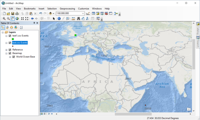

You have the latitudes and longitudes reversed in your table (latitude should be 51°) and what I'm guessing is an incorrect coordinate system. Here's an example of using the first coordinate with your naming convention (test.csv) and with the column names reversed (test1.csv). Your improper coordinate system is probably putting it on the other side of Africa.

You're setting the coordinate system to be UTM, but the coordinates in your file are in lat/long. What happens when you use a geographic projection (WGS84, for example)?
