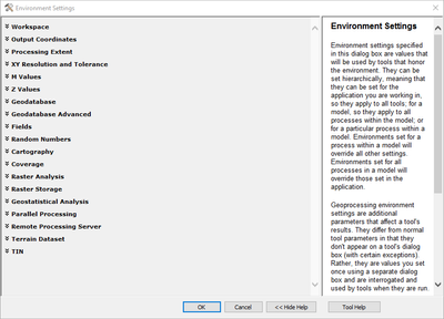

Has anyone found where the Geoprocessing Environment Settings are stored in ArcGIS Desktop 10.7.1? I  looked in the registry but didn't find them there (I could have missed them). I determined that they are not stored in normal.mxt. I also looked around in the profile area at C:\Users\<user>\AppData\Roaming\ESRI\Desktop10.7\ArcMap.

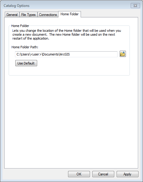

Also, does anyone know where this setting (below) is stored (the file or registry location)? This screen capture is the Options dialog from the Catalog window.
<edit1>Edit: I found the blog post linked below answering my last question.
https://community.esri.com/t5/esri-technical-support-blog/want-to-redirect-your-default-geodatabase/...
</edit1>
It would nice to be able to access these settings in a file or the registry so we could establish the same settings throughout the company, without making the changes manually at every installation. This would be done at the time when Desktop is installed.

And it looks like you've sorted it but settings are typically saved in Normal.mxt, Normal.gxt (arcatalog defaults, used for new map documents), and in the HKCU registry settings.
