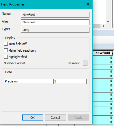

I'm attempting to load a dataset (D1) into another dataset (D2) and need all the field types to match. I am attempting to switch several of the fields in D1 from "Long Integer" to "Short Integer" to match D2's "Short" fields. However, when I go to "Add Field" in D1 and select "Short Integer", the resulting field defaults to "Long Integer". I have no idea why this is happening:
This change in types is happening directly after creating the field, and I haven't even begun loading new data into it with the Field Calculator. Does anyone know why this is happening? It's frustrating because I performed about 10 of these conversions before noticing this issue. Any advice would be greatly appreciated!
SOLUTION:
When creating the field, if the "Precision" value is 5 or more, the field will default to "Long". For me, the default precision value when selecting "Short" was 0, but I had to change it to 4 to get the "Short" type to stay. Hope this helps someone!
