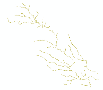

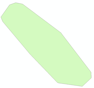

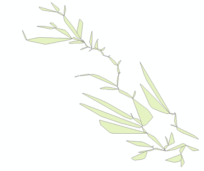

You could use Minimum Bounding Geometry with "Convex Hull" as the geometry type.
I used it on a river network.
Result for original streams
Result with Merged/Dissolved Streams

JustineGüldenpfennig
That looks nice, and seems to work just fine for me. Thank you!
