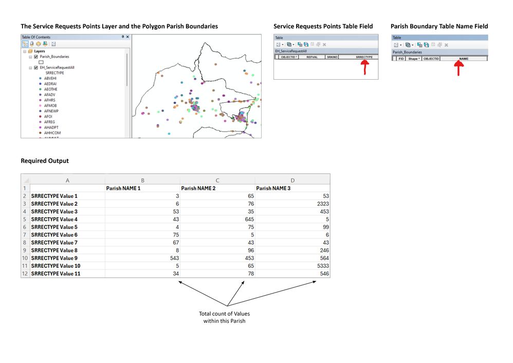

Please bare with me!  I have been given a task which the way I would normally think of doing it would take quite some time and I think there must be a better way to do it.  I will try my best to explain and hopefully someone can help (if you understand my drivel!).
The point of the task is this in simple terms:  As a local authority we want to be able to see how many requests we get from each parish area in order to be able to best divide them up by members of staff to give roughly even workloads.
I have a GIS layer (points) with many records on it.  There is a field on this layer which gives an abbreviation of the type of request being made.  There is approximately 250 types of request, and a quite a few thousand records on the layer.
I also have a layer which shows all of the Parish boundaries in the area (approx 25).
The output required
The desired output is to give me a table/spreadsheet (I guess excel) which gives me a total per parish for each type of request.  I will mock up something like I am hoping to achieve and attach it to this message.  I am open to better ways of doing this! Thank you.Details.jpg

I think I have manage to do a Spatial Join - I now have a points layer which contains both the Request Type code and the Parish it falls in (see picture).  I am now trying to get this to the final format of showing me how many Requests are in each Parish by Type (as per my original output image).  I have the Summary stat tool up  trying to work out how to do this but failing! If this is the best method (I note the other replies below suggested alternatives), could you walk me though it? Thank you!
