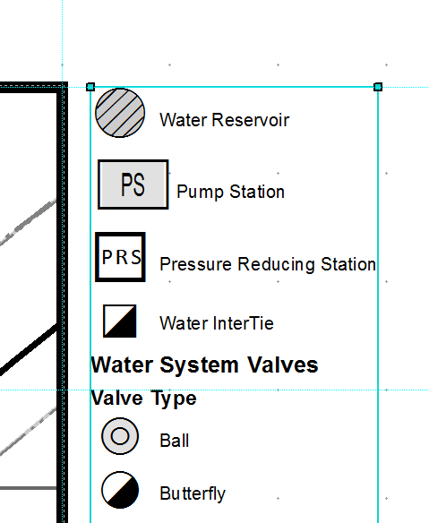

Hello,
I am detailing all the elements of an atlas type map created in ArcMap for a consultant to reproduce. The idea is that a pdf ( I know!) is created and that there is consistency. The consultant is capturing data and therefore some data may be available to the consultant prior than me.
How can I document the actual size of a symbol when it is in a legend? When I look at the properties I get the information about the text of the symbol, and not the symbol. See below...

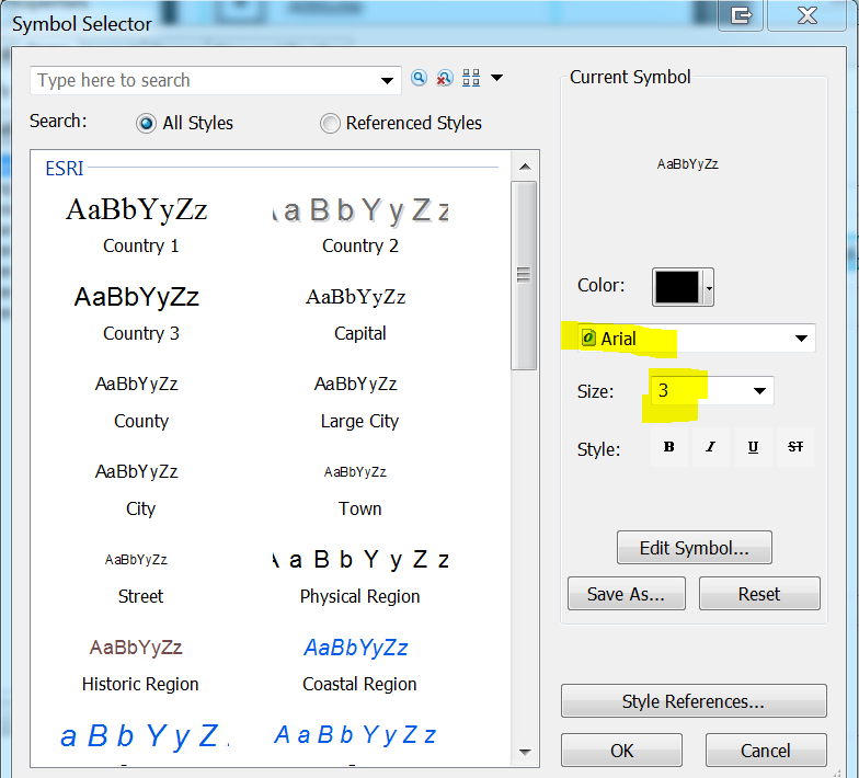

You should be able to view and specify the symbol size by left-clicking on the symbol in the Table of Contents.
For example:
symbol properties example
PilarYager
Is this the size of the symbol in the legend also? I thought this was only for the symbol size in the data frame.
StephenM
As long as the legend hasn't been converted to graphics and the symbols aren't being scaled based on a reference scale, symbols in the legend should scale to match the symbol size selected.
