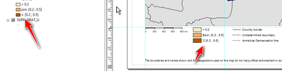

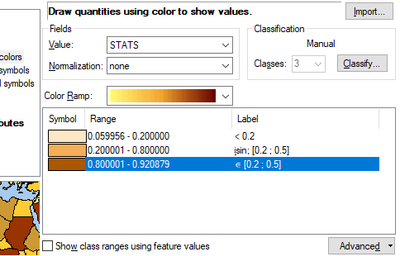

In Arcmap I am trying to write the special character "include in range" (looks like this  ∈ )  in the label text but only a white square appears..  (I have tried to use the html code ∈  but I might use a wrong syntax.

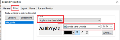

Double-click the legend to open the Legend Properties.
Under the Legend Properties > Items, change the required font to Lucida Sans Unicode.
Once done, you could see the desired symbol in the legend.

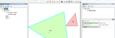

The following symbol has worked for me.

weird.. it does not work for me in the layout view... it looks fine in the ToC (as for you), but not in the layout view it-self where the ∈ - symbol is shown as a square  (placeholder?)...
Which arcmap version do you use?

Got you. I didn't realize the issue was with the legend element.
Think Location
Jørgen
Fantastic... it worked 🙂 have a nice day 🙂
