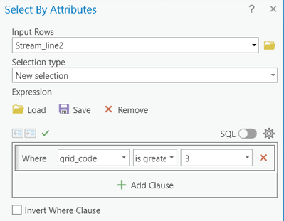

I was wondering if anyone could help me with my problem. I have a shapefile with polylines which have associated attributes including the Strahler order. I was wondering if anyone knew how to select only networks which had a minimum order of 3.
I have tried using the select by attributes function where "Stream_Ord" >= 3 however this does not seem to work as it only selects segments of fluvial networks not the whole network.

Step-1: Select by Attribute
where grid_code >= 3
Step-2: Select By Location
Input Features: Str_order layer
Relationship: Intersect
Selecting Features: Str_order layer
Selection Type: Add to current selection
Click Apply multiple times (till the number of selected features in your attribute table doesn't increase any more).
