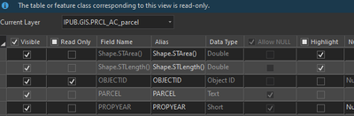

I am in an MS SQL Server EGDB using ArcMap 10.7.1 and I see the same behavior. When the FC has no join. the Shape_area() and Shape_length() fields are there, after joining to an enterprise table or FC, they are gone. Not just turned off, gone.
Decided to try it in Pro and the behavior is different. The fields are still there but they are at the beginning of the list of fields:
