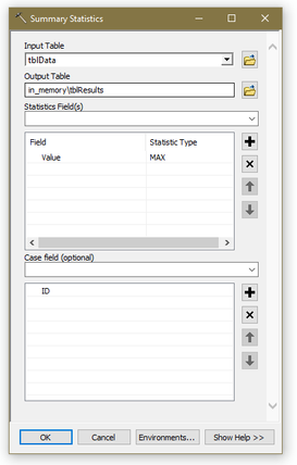

DuncanHornby
MVP Notable Contributor
I don't believe File GeoDatabases support GROUP BY when selecting rows in a table? A quick search of this forum and GIS SE and you see many threads about the issue.
If you want to create a table of just that data (which is different to selecting rows) then you can use the summary statistics tool as shown below:
khalidechlouchi
Thank you DuncanHornby,  you are right, GROUP BY is not supported in geodatabases file and shape files, I think I will try to do it on personal geodatabase with ACCESS.
