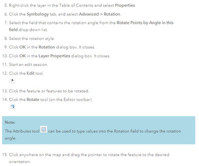

Apologies, I just noticed it's an ArcMap question. I rotate symbols in ArcMap using this method
 https://support.esri.com/en/technical-article/000007259#:~:text=Click%20the%20Symbology%20tab%2C%20a....

NicoleWeston
