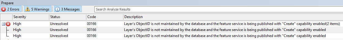

When I go to publish, I get an error about no ObjectID:

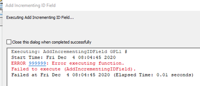

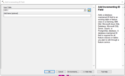

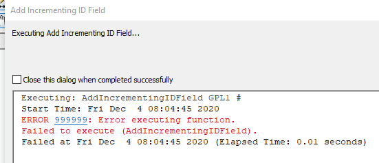

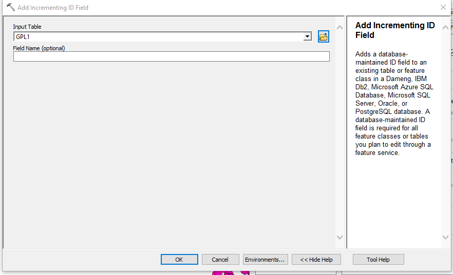

I can right click the error and select Add Incrementing IDs option which opens the Add Incrementing ID tool. When I run this, I get an error:

You can't add an OBJECTID field to a query layer, you have to select one of the participating tables' OBJECTIDs.
SELECT t1.OBJECTID, t1.field1, t2.field1 FROM ... AS t1 JOIN ... AS t2 ON ...
You should be able to share that as a feature layer. However, I'm pretty sure you won't be able to publish it in a way that users can create new features. For that, you have to publish the original feature classes with write privileges (you can still hide fields).
