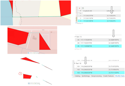

Are you sure this was related to donut shapes and not empty geometries? I am encountering this issue (above code) at a low-percentage rate when dealing with data sourced from Open Street Maps.
When I take a close look at them they all have one thing in common: All x- or y-coordinates of a multi-part polygon share the same value (see image). Thus leading to a line aka empty polygon.
I am trying to insert into a PostgreSQL Enterprise Geodatabase (using st_geometry) but these records fail. Anything I can do here to get them to load in? I.e. casting or transforming...? Thinking of looping through and checking the area value of each polygon within a multi-polygon. If 0, then remove it, so at least the rest of the multi-polygon loads in and it doesn't prevent the whole insert.
Here are a few offenders:
