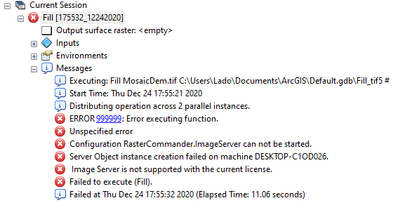

Hi,
I have created a mosaic of two DEM files,  from >Mosaic To New Raster< after I entered all requirements, it was done successfully, but when I want to work with Hydrology tools (fill, flow direction, etc) it does not work, there is an unspecified error. The problem occurs only after making the mosaic.
Can anyone help me? I am using ArcMap 10.6.1

You'd really need to give more information about error messages, your data format etc. (pictures paint a thousand words also) for anyone to start to help you.
How do various samples of the cell values compare to the original 2 DEMs? Is the projection defined? Calculated statistics?
LadoKhandolishvili
@DavidPike This is the error message.
I have tried to make a mosaic with SRTM and ALOS DEM data, but the results are the same.
DEMs original cell size (X,Y) is 0.00027777778, 0.00027777778
Pixel Type - signed integer
Pixel Depth 16 bit
During creating the new mosaic I remained all this information, also I have tried on the original coordinate system which is GCS_WGS_1984. Also, I have tried to change raster projection into the projected coordinate system WGS_1984_UTM_Zone_38N and after tried to create the mosaic. The results are the same, the mosaic is creating but when I want to use hydrology tools an error occurs.

LadoKhandolishvili
Thank you, that was really helpful. I used your advice in every step, particularly: When I created Mosaic Raster I specified
1. Projection
2. Cell size
3. Parallel processing factor to 0
I repeated these steps in every hydrology tool calculation and it worked.
