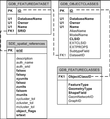

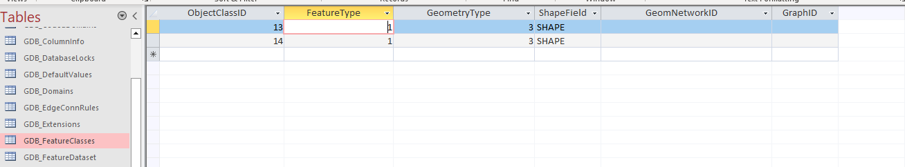

Okay. According to ArcGIS Server for the Java Platform 9.3 Help (esri.com), the feature datasets are linked to feature classes via the GDB_ObjectClasses table.
So, in my test database:
Not sure how far back feature datasets were introduced, but for version 10+, use GDB_Items and for 9 (and maybe earlier) use GDB_ObjectClasses.

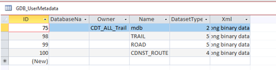

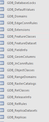

I don't have a GDB_Items table.
The only thing that lists all of them (feature classes, feature dataset) is GDB_UserMetadata
This is an .mdb, and ArcMap/Catalog correctly shows them as being inside the feature dataset.
