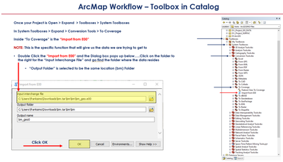

We need the old Interchange Tool from ArcMap to still breakdown old data formats.
Conversion Tools > To Coverage > Import from E00
I can provide the workflow to get these to work if you email me.
