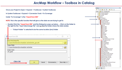

FrankSims
Or.........they could just add the tool back
We need the old Interchange Tool from ArcMap to still breakdown old data formats.
Conversion Tools > To Coverage > Import from E00
