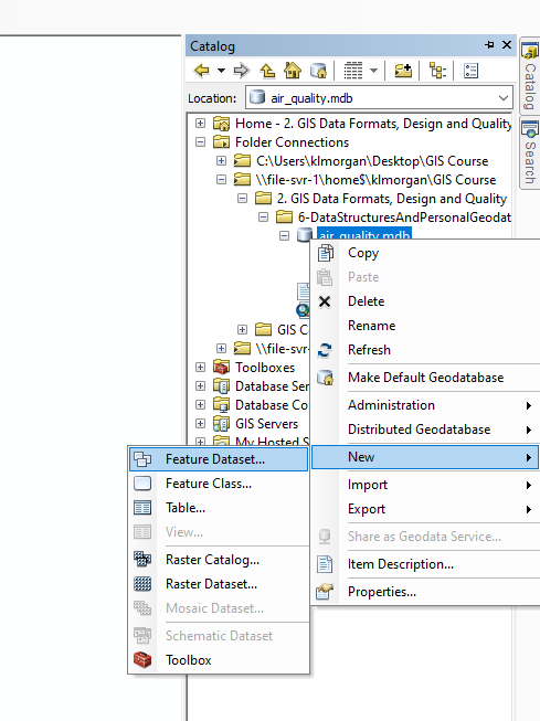

I'm currently taking the UC Davis/Coursera ArcGIS certification program and have encountered an issue I can't find mentioned elsewhere. I need to define a relationship between a feature class and a data table, but when right clicking on my database and selecting "new", there is no option for creating a relationship class.
EDIT: When searching for "relationship classes" and navigating to the relationship class toolbox it appears that I don't have the proper license to execute the selected tool. If anyone knows how to create a relationship between a feature class and a data table some other way, guidance would be appreciated.
I'm running ArcMap 10.6 and so far have not encountered any other issues with missing features. Screenshots below.

What I see:

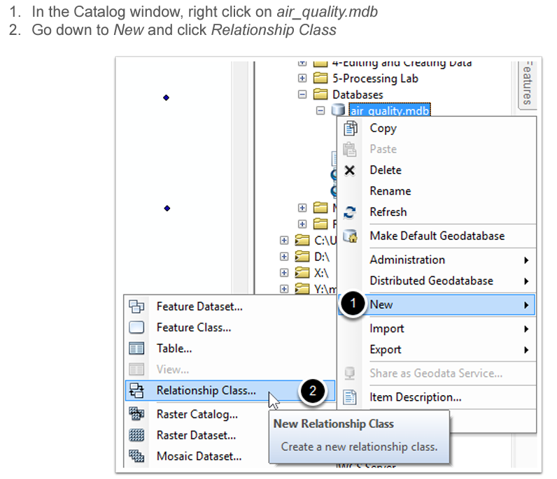

What I should see according to the course instructions:
QuantitativeFuturist
@KLMORGAN If you have a "basic" license you're out of luck. Can you get a home use license and use that?
KLMORGAN
I should be able to get the student license offered with the course and replace my current version with that.
