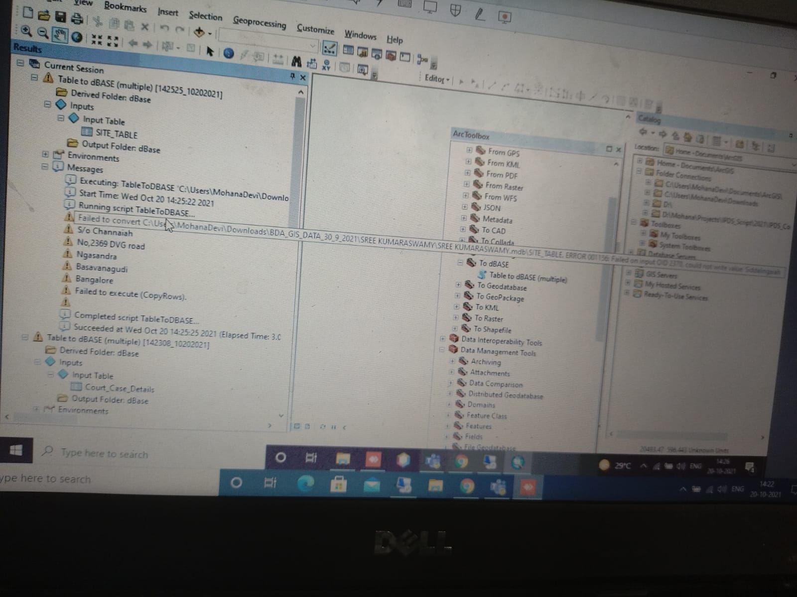

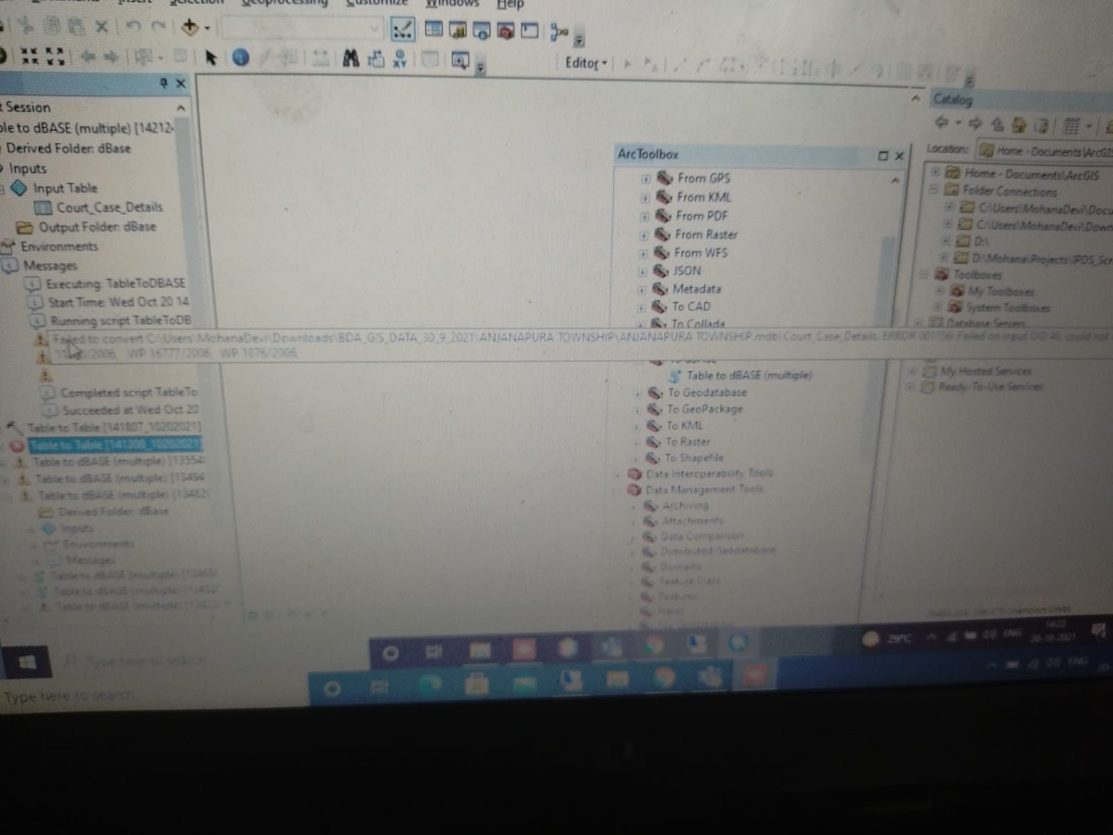

Hi All,
I have persnol Geo database (.mdb) which contains feature classes and 15 non spatial tables.
I converted feature classes into shape files.
I need to convert non spatial tables into dBASE files. (.dbf file). For that conversion I used table to dBase tool in ArcGIS Desktop (ArcMap).
By using this tool I converted 12 tables. But I can't able to convert remaining 3 tables, it throws errors.
I have checked with other tools like Table To Table and CopyRows also. It also throws same errors.
I can't able to find the solution for this.
I have attached error files below.
It would be great pleasure if anyone can help me out in this.
