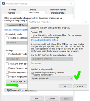

Hey All,
I have switched recentley from 1080p dispaly to 4K one.
After that upgrade I have noticed the icon sizes are very small, When I switched back to 1080p its all fine but the UI isnt sacling to 4K. I have made the icon bigger in the costumize menu and it helped a bit but not all the icons git bigger and the text stayed small with no change.
Do anyone know how to increase the UI scale or increase the text size?

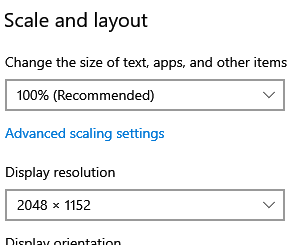

Do you have the Scale and Layout set to 100%

I got you, RoeeBaeloha.  This can be achieved.   See my first screenshot.  Make sure you set it to System (Enhanced).  This honors the Windows "Scale and layout settings" see my second screenshot.  I think you'll find that looks much better than your screenshot.  You can turn off "Large Icons" after you change this setting, I see you found that option in customize mode.
