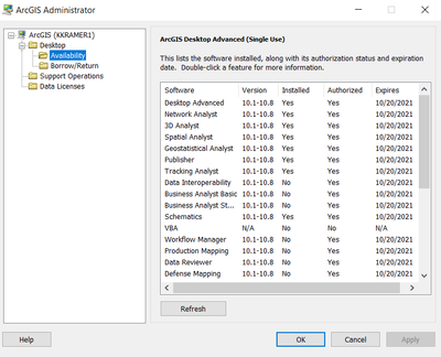

Hello, I have a one year student license to ArcGIS 10.7.1 that expires sometime in March or April, how can I find out the exact date?  I found instructions on esri.com for going to a license manager for 10.3 to find this out but that does not seem to exist for 10.7 (or at least is not accessed the same way.  Thanks.

Open ArcGIS Administrator.
Click on Availability.
You should see when the license expires.

That was simple, thanks!
