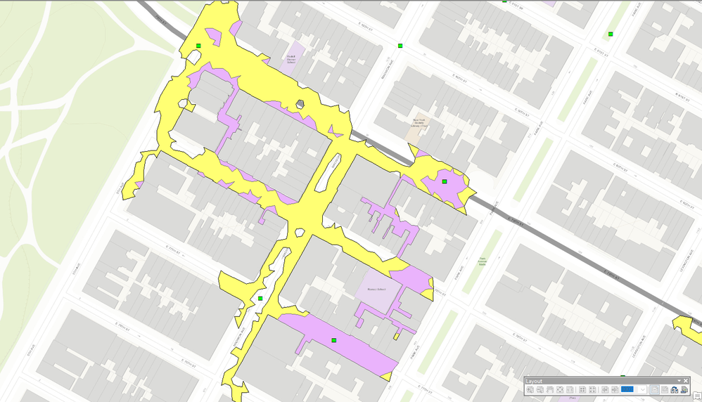

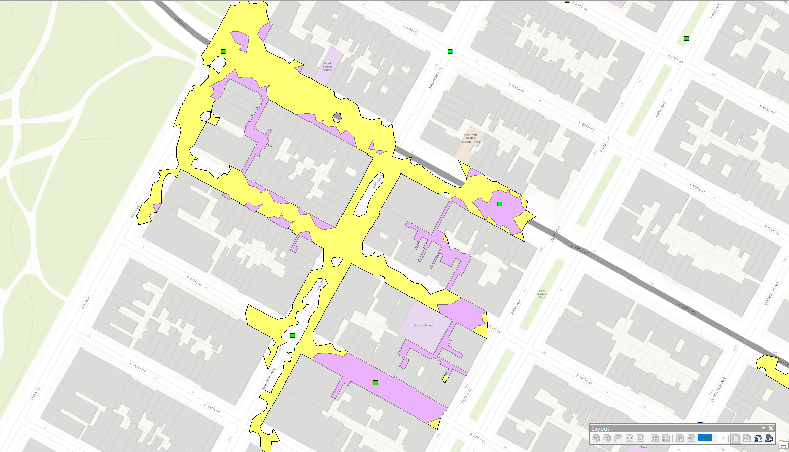

I have two layers in ArcMap. One contains flooding areas in a city, categorized by nuisance flooding (objectid 1 and represented by color yellow) and deep flooding (objectid 2 and represented by color purple). I also have another layer, containing street flooding complaints from residents in a given year (represented by the green box symbol, and utilizes lat/long coord from a .csv file). I want to create a new layer that only highlights the areas on the map that are deep flooding AND has flooding complaint(s) within the deep (purple) flooding area. Flooding complaints within nuisance (yellow) flooding or unshaded areas are to be excluded from this layer. Below is a screenshot of my current map:

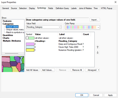

Yes, there is an objectID for each row for the nuisance and deep flooding layer. I've attached some screenshots for a closer look.
I was actually able to perform the spatial join operation (by right clicking on the flooding area to join and relate instead of the flooding complaints layer). However, the problem that remains now is that it is still treating both the nuisance and deep flooding as one, when I want only deep flooding to join with the flooding complaints. I am not sure how to only select the deep flooding object/ category
