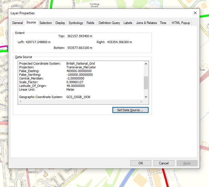

David, I don't have a 'Coordinate System' tab on my layer properties dialog box, only those shown. So I can't really do the Transformations you mention on-the-fly, unfortunately. Is it normal to have a 'Coordinate System' tab? Stephen
