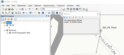

The simplest solution may be to just use the "Measure" tool
This will snap to existing features - and you can set the units as you desire.
Another option you may be able to use is the Point Distance tool https://desktop.arcgis.com/en/arcmap/latest/tools/analysis-toolbox/point-distance.htm
Of course, these both only provide the 2D distance.
