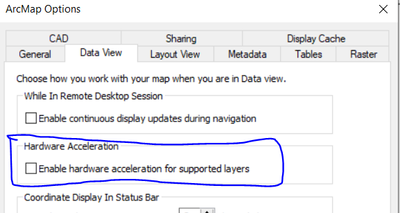

1. Clear Display Cache . Customize > ArcMap Options > Display Cache (Tab) > Clear Cache.
Also in Data View (Tab) > ensure "Enable Hardware Configuration for Supported layers" is unchecked.
Try adding the Streets Basemap.

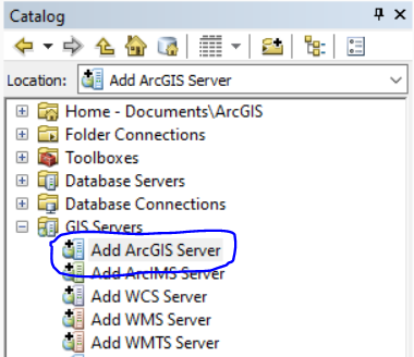

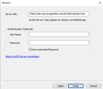

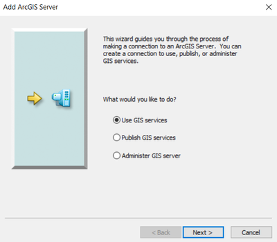

2. Add https://services.arcgisonline.com/ArcGIS/rest/services  to Catalog > Drag and drop "World StreetMap" to Table of Content.
