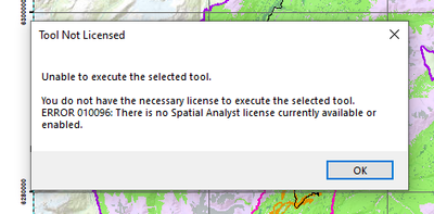

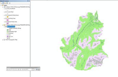

I'm in the process of trying to utilize ArcToolbox to convert a raster image into polygons for use in CAD. Unfortunately the raster to polygon tool won't work as the raster image contains floating raster points (32 bit). I found a potential solution of utilizing the raster calculator to convert a floating type raster to a polygon feature class but It's not under my current license (using ArcMap). I'm wondering if there's a different solution with the version I have or if I'm simply out of luck. Thanks in advance!

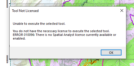

BradyHay
Appreciate the replies Dan. Unfortunately I'm not currently licensed to use the raster calculator (initial image). I'll have to discuss our current licensing internally in order to complete the task.
