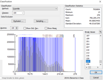

1. Under Symbology > Classified > Press Classify button.
Change the classification method to "Quantile". Change classes to 100.
Under Break Values, note the value of 1st break (28 in my example) and 99th break (225 in my example).

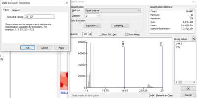

2. Then, click "Exclusion..." button. And define the 1st and 99th break value with a hyphen (e.g. 28-225 or 28.01-224.99).
Now change the Classification method to "Equal Interval" and classes to 2. Click OK
