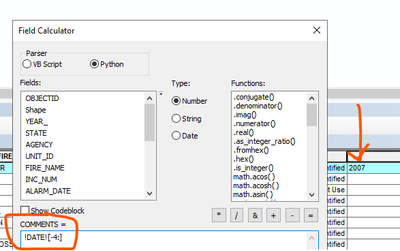

@ScottRobinson If all the dates are in a standard format, you could just split the year out into a new field
Using something like !DATE![-4:] in the Field Calculator.
Then just symbolize using Unique Value on the year.
There are probably a number of other ways to do this, but this one should work pretty easily.
ScottRobinson
I've done that and it works.  I've also used year() and that works, too.  Trouble is our foresters are continually adding new polygons with new dates.  Those won't get picked up unless I go in and do the field calculator.
