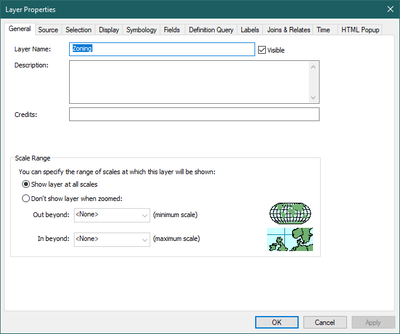

I created a 25 feet polygon buffer around a point layer, and when I open the buffer layer in ArcCatalog I do not see any feature, also when I open the same layer in ArcMap, features are not visible, I do have to zoon in a lot to see anything.

If you have to zoom, it sounds likely you've got a scale range set. See anything on the general tab of the layer's properties? Select "Show layer at all scales" to clear those settings.
