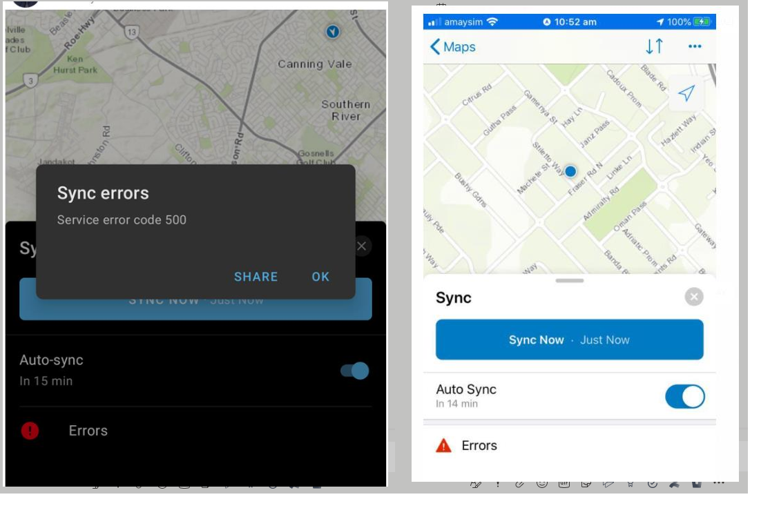

We recently helped a client migrate from classic workforce to workforce v2 and we started noticing alot of sync error between the mobile and server. (see screenshot below).
To provide some context, we have a client whose field officer(10 worker in a shift) comes in every morning, pick up a tablet and sign into workforce/survey123. At the end of the shift they would sign out. What we have noticed is that when different users sign in and out of the same device, they have a tendency to get the sync error as shown below.
To fix the sync issue, the user will have to clear cache/storage (android)  and on IOS (reload project). This isn't great as the worker are not tech savvy and frequently get unsync/outdated assignment (we have background code to manipulate the assignments) which leads to alot of confusion.

Unfortunately, there's not enough information from the error code to help diagnose the issue.
Are there any pending edits when the Worker tries to sign out?

Thank you for that, your suggestion about the pending edit have possibly struck the nail. I was able to replicate the issue in the scenario
User 1 login to device 1. make and edit (unsync) and log out
User 1 then login to device 2, make and edit (sync) and log out
User 1 then login make to device 1 and the sync will break, (i am assuming the replicas fails to reconcile).
Do you think this is a bug or a limitation of the product? i am pretty sure the users don't check if an edit is synced or not when they log out
