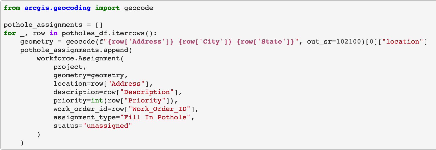

Again, this worked.  However I can't seem to get the same script to work in a Jupyter notebook. The sample notebook geocodes an address to an x,y location which I already have.  My assignments csv does not have addresses, only x,y location in separate columns (exported from the Assignments Point Layer - see sample below) as the points are along river levees and don't necessarily have addresses, and i used the location field in Workforce for the name of the levee that is to be inspected. How do I get the script to recognize my x,y data?  I've tried converting the x,y data into a single column titled SHAPE with formatting like this: {"x": -122.366238, "y": 47.22577965}.  This seemed to work but as the script created the assignments,  there was no symbology for the new assignments - similar to the discussion here: Workforce 'create assignments from csv' script - no assignments symbolized on map
I'm really hoping to use notebooks rather than Command Prompt scripts so I can document processes and share more easily.
I'm pretty sure I need to change at least the geometry line(s)?

You'll want to change how the geometry is created. In the script this is created from the X,Y, and spatial reference. You can see it here: workforce-scripts/create_assignments_from_csv.py at master · Esri/workforce-scripts · GitHub
This is un-tested but I think you want to do something like:
geometry =  {
    "x": row["x"],
    "y": row["y],
    "spatialReference": {
        "wkid": 102100

DaveSarver1
That worked!  Thank you Aaron!!!
