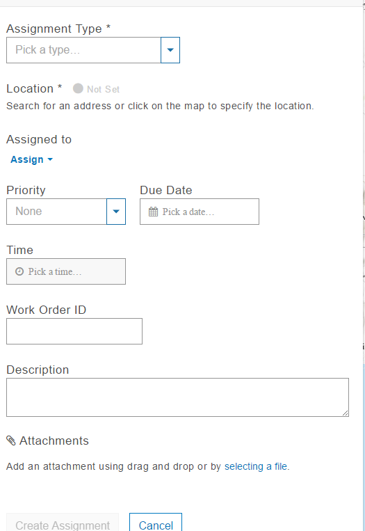

I have the following questions for the workforce:
  1. is it possible to change the app design? change logo, icon, title, color, etc...
  2. is it possible to change the fields in this screenshot? i tried changing the fields in the feature layer, i removed one and added other fields, but it didnt work.workforce.PNG
  3. is it possible to remove the navigator app from the available apps? and maybe add another app?
  4. is it possible w add the assignments from another feature class instead of adding them one by one from the browser?
And if there is a tech support that i can contact please let me know.
Thank you in advance
