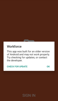

Hi Mele,
Are you seeing the below message? or you have experienced something different?
On newer versions of Android, you will notice this message:
It is a one time thing and more of a reminder to the user. However, the dialog gets closed once you hit OK and then you can continue using Workforce app as expected.
 -Neel
MeleKoneya1
Neel,  Thanks for the response.    We did click OK and then saw this message even though the worker was in the project.     I did open a case as it seems it should work, but it is not working on my Android device and our Fire staff android users.
