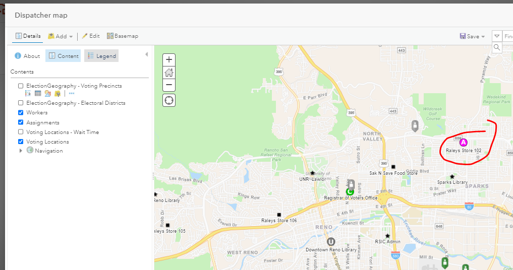

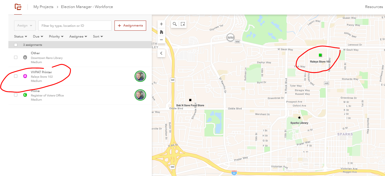

The Assignments show up in the left-hand LIST of Assignments, but not on the map.  In the screen shot below, the polling location shows as a green box (meaning it is a Ballot Drop Off and is OPEN), but the Assignment is not showing.
The odd thing is, if I go to CONFIGURE and DISPATCHER MAP, the Assignment icons DO show up inside the Dispatcher map itself.  Just not when the map is shown within the Workforce app.

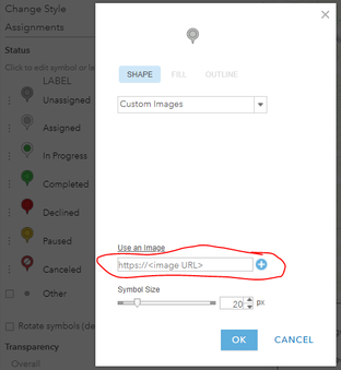

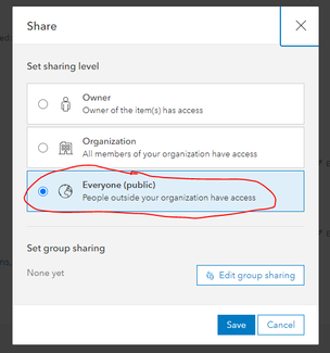

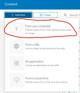

RyanMiller6
As an alternative, if you don't have an in-house content system you can add the images for the custom symbols to ArcGIS Online, share them with the public, copy the service URL into the symbology for your layer.  Be sure to click "View" to use the full link with the token (see below).
