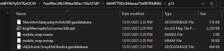

I'm wondering if its possible to use an offline TPK file as basemap for the field worker app?
I know in Collector and Co you can use one if you store the file in a Basemaps folder. However, it seems that this doesn't work in ArcGIS Workforce.
If I create an offline area from the webmap (using the Workforce interface), I'm getting a TPK (see below). So assume somehow it should be possible.

No, this is not supported in Workforce. It will be supported when Workforce moves into Field Maps which is tentatively planned to start later this year.
