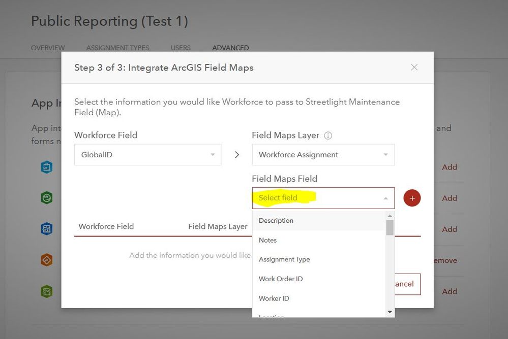

Thanks for your response. I am trying to get this to work with our Hydrant Inspection Solution.
Does the Global_ID need to be the pop-up title for both the dispatcher map and the assignments map? Is it necessary for the ArcGIS Field Maps pop-up, too?
Thanks for your help.
PaulGiroux1
Hi @David , any luck with this.

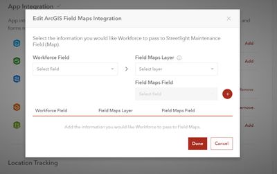

I have a workforce assignments feature layer I extended with a public survey123 form for reporting (creates unassigned workforce assignments for dispatch). I extended the same Assignments layer with maintenance related fields for field crew work (using field maps).
I'm basically using one FC then wanting Workforce to open the field map with the same GlobalID but it doesn't show on the field map side. I tried adding an expression FromWFGlobalID in the field map to see if it would show in the field map fields list when mapping Workforce to Field Maps.
Can you tell me what/how to config the pop up to pass the workforce assignment globalid to the globalid which is a match in my field map since I use the same jury rigged feature layer?
cc @CraigGillgrass
PaulGiroux1
Update: Tried the GlobalID in Title hack but when I pass from WF to Field Maps, it still triggers a collect new and not edit existing.
A just good enough for now works by:
1. In App Integration, Pick a specific Field Map but I do NOT map fields from WF to F Maps (I tried everything but it just triggers a collect). So... pick a map, don't pass fields.

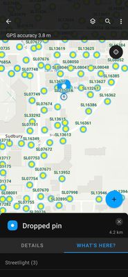

2. Mobile Workforce, users select Open In Field Maps which drops a pin at the right location, then from the "What's here", they can simply select the Feature and edit in field maps then close the work order right in the Field Maps interface.
OLD WORKFLOW
- get's around the crews having to 1. Open in Workforce, 2. Select Open in Field Maps, 3. Doing Maintenance by  collecting new in a separate feature layer then 4. Remembering to go in Workforce to close the work, etc.
Note: 4. will often be forgotten, frustrating Dispatch
NEW (HACKY WORKFLOW)
1. Open in Workforce, 2. Select Open in Field Maps, 3. Select Assignment in "What's Here" 4. Do maintenance in Field Maps against the extended Assignments layer, 5. Update Assignment status & fields then save which immediately takes effect in Workforce for dispatch & public reporting maps*.
Pros: More streamlined, easier, better for dispatch, better for field
Cons: Does not immediately edit the right feature in Field Maps (aka eliminate 3. in HACKY WORKFLOW).
Note: Hacky but delicious. This workflow will ... um... flow work better. Esri, hurry and get Workforce and Field Maps integrated pronto! I'll buy you (um, well, just 1 employee) snacks when you do!
