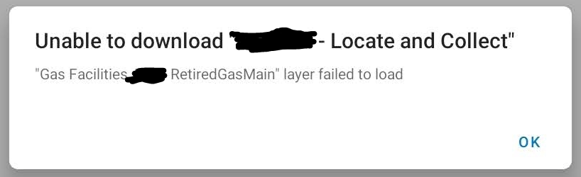

One of my projects is having this issue as well.  Layers that were viewable in the field in Classic are now preventing the project from downloading at all.  Everything displays properly in the Worker and Dispatcher maps online.  I am not the owner of the layers i'm having issues with so that may be affecting things.
We aren't having the basemap issue that I've seen.

DCMcLain
This is the error message we get when I try to download the project.  These are the same layers I'm currently using in another project that was built in Classic and they display fine.  I am not defining a map area beyond what the original map extent was.
I do not see any errors on the Overview tab.  I did get a yellow triangle error originally when some of the layers weren't synced.
