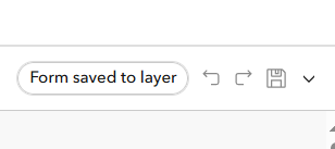

I was running into this issue (my maps weren't coming up in the list for the Integrate Field maps dialog). In my case, it wasn't about the sharing, but rather the map/layer settings. When you are configuring your form for field maps, you need to use the option "save to layer" rather than "save to map" in the upper right:
