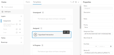

I am currently working on using Field Maps Designer to allow mobile workers to create Workforce assignments in the field with the Field Maps App. Field Maps designer allows you to select which fields to display and it allows you to set default values. I was able to automatically set the Status field to Assigned, and pre-populate the WorkerID field (all of my assignments will be assigned to the same user) within the Templates tab.
